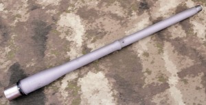

Rainier Arms UltraMatch 18 308AR Barrel.”
Rainier Arms UltraMatch 18″ 308AR Barrel
I had initially selected a JP Rifles SuperMatch Barrel for this project sort of as a spare no expense approach. Unfortunately, the barrels were never available for purchase. Upon receiving an in-stock notification for Rainier’s UltraMatch barrel, I decided to move this project forward.
Description:
From “RA,” We wanted to build a .308 barrel using the finest blank and mass produce them to bring them to market at the most competitive prices. Our UltraMatch™ barrels start as Shilen blanks and contoured to our specifications. We wanted the best balance between accuracy while keeping the weight down as much as possible. The Rainier Match Chamber is a modified .308 WIN-7.62 NATO chamber to produce ultimate reliability and accuracy shooting the 7.62 NATO & .308 WIN rounds.
Features:
- Stainless Steel Match Grade Shilen Blank
- Length: 18″
- Twist: 1:10
- Gas Block Seat: .750 Diameter
- Thread Pitch: 5/8X24
- Weight: 2 lbs 10 oz
- .308 Rainier Match Chamber
- Mid Gas System
- 6 Groove
- M4 Feed Ramps
- Proprietary Contour
- Bead Blasted Finish
